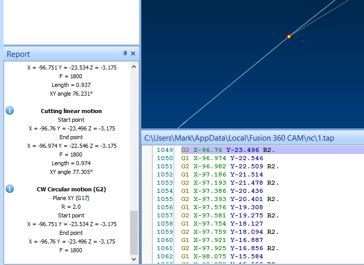

Here's a couple of screen shots of what I think is the problem area, the first shows a very short helical move, the next image show a line move. All around the ramp you have the same short helical move then a line, this might be whats causing your control problems.
The feed in the g code is constant so it must be the way the control is processing the g code. I don't know if there's a setting that will give all line moves for the ramp, that might be better than the short arcs and lines.

There's something odd with the 2d contouring toolpath, without smoothing Fusion usually fits arc to 2d fillets but in your file that's not happening.  Some rads are there like this.
But the other corners are made of lots of small arcs and lines.
Constantly changing from arcs to lines might be what's slowing your feed rates.
I did a quick test on some simple rounded rectangles, one made adding fillets to a box the other by filleting a 2d sketch and extruding. Both of these converted to 1 arc for each corner, this is with smoothing off.
I don't know what's wrong in your file, perhaps someone from Autodesk should take a look.
All the way around you part you seem to get 1 short line move the 1 very short arc. Arc move shown in the red circle.

OK I figured out what's going on, when Fusion converts that curve into line segments it's trying to fit a rad to all the corners, like it would if you machine around the outside of a 90°  corner. If you turn off corner rounding and set it to Keep sharp corner then set you tolerance and smoothing to 0.015 you get a lot nicer toolpath.
The area where you where getting problems now looks like this.
I've had another look at you sketch and I think the curve that's causing the problems is a conic curve, for some reason the CAM is not doing a good job converting it to lines. Definitely one for the CAM team to look at.

The issue is that the fillet isn’t an arc for some reason. If I measure a different fillet I get Length, Radius, Diameter, and so on. But if I measure the fillet in question all I get is length. For some reason Fusion is creating what seems to be a spine instead of an arc.
