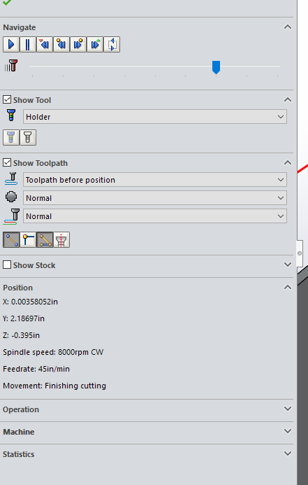

Has anyone experienced any issues with the arc center not being correct in milling?
I have a 180 deg semi circle and its center is located at x0 y0 but the the tool paths in SW is off and the posted code show the y center being off .0043"
I drive the tool path off the edge of the model and it is off.  I created a sketch circle that is concentric to the model and if I cut a full cirlce the toolpath and code are correct?
In the below I have duplicated the operation and selected both so both toolpaths are displayed. One is drive off model edge and the other off sketch. You can see in the first image they overlap.  As you approach the top they no longer line up.  I can't share the file publicy.  I shared it with @jeff.walters.
Was more curious if anyone else was seeing this.  I found it by cutting 2 parts and putting them together and they were correct across the split but off .009" the other direction and scrapped the first sets.

I looked at your issue now. The problem has to do with our internal smoothing which just looks at the tolerance when making sure toolpath is ok. The arc center can be moved around a lot within a given tolerance.
In this case you can set Minimum Cutting Radius to 0 which will force smoothing to be off which again ensures the desired arc center.
Another parameter that can change arcs would be Compensation Radius Allowance (for lead ins/outs). But in this case that is not the issue.
I can look into why the smoothing in this case moves the center but in general this is permitted. But you can work around this problem but setting the Minimum Cutting Radius. Smoothing is generally desired to remove redundant points in the toolpath but it will change the toolpath slightly.

If the tolerance is set to .0004" how could the toolpath pass as okay if it is off .0041" or a factor of 10x the tolerance.
Message 16 of 77
fonsecr
The arc center is not directly important when checking that the toolpath is ok. You can move the center a lot before it causes arc curve to fall out of tolerance. So you cannot assume that the center will move only within the given tolerance from the ideal arc center.
René
René Fonseca
Software Architect
Message 17 of 77
Lonnie.Cady
I understand that, but in this case it causes the entire toolpath to be off by the distance it is below center.  I cut 2 of the pieces in the file.  I put them together to create a single ring the measurement across the split vs 90 deg to the split was off .0085" or about .0045" per part.  So regardless of where the arc center ended up the toolpath does not stay with in tolerance.
So if you completely remove the arc center from the equation the the toolpath is still incorrect. At the top of the y axis the toolpath is off regardless of the arc center position by 10x the tolerance.
It is obviously over my head on this, but how can I be sure things like arcs like this are in the proper true position?  I did not have smoothing turned on and the tolerance was set to an acceptable level for this part.  How could one deduce that the min cutting radius would effect the internal smoothing and there by shift the toolpath .0041"
In the attached screen captures I tried to stop at x 0 as close as I could for both toolpaths.  If you do the math between the 2 toolpaths the y axis is off .00414".  Is that the toolpath that is being check against the tolerance?  If so it is off by 10x.  If not what toolpath is beign checked against the tolerance I set for the part.

I analyzed it now and located the problem. I created ticket CAM-4191 for the team to look at.
