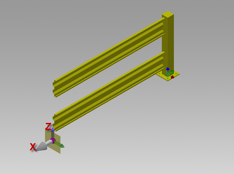

I am having problems getting two user assets to connect properly.  It seems like I have tried every possible orientation of  X,Y and Z to no avail.  These are parametric guardrails similar to the guardrail in the system assets.  I tried to even make the connection points in the same orientation as the system asset but it does not work.  The system assets attach to each other fine so I don't know what I'm doing wrong.

Is this what you're trying to achieve? (See attached.) I was unable to replicate your problem.

Yes but mine will not connect that way. I'm not sure why.

Thanks Ted!  I adjusted my settings to be like yours and I still have this problem (see attached)

The problem is that the direction of X , Z axis  are not correct when you change the asset variant as 8ft_1_Post. Please make sure the +Z direction is vertical to the landing surface, whilst +X direction is along with the way of chain. Please give a try to the asset I edited as attached.
