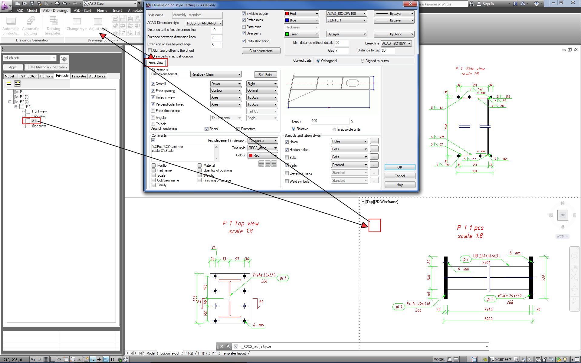

If you use any of dimensioning styles from Group or Assemblies there is a tab "Detailed View".
How could I use it?
If I add Cross-section/Detailed View to template - it uses settings from "Front view " instead.
In properties it shows that ype is some mysterious "Custom View? (it should be "Detailed View" I think).
How could I change it to use setings from tab "Detailed View"?

Try this. Activate the new section and click "Adjust Style" - What do you see?

Thank you. I do it like that, but I would like it to use the correct tab from same style.
You can do it by changing dimensiong style views one by one from general to detailed. Then it uses the settings from detailed tab.
But to change all views one by one is too tedious work,
So I should be able to set this via template.
Wishlist item or Bug?
