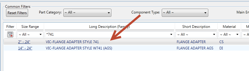

Are you using this item:
If you are, you should be getting the GRV/FL mismatch, b/c the adapter is PL on one end and FL on the other.  Maybe attaching a sample model with the adapter you are using with a sample equipment would help troubleshoot the issue.
