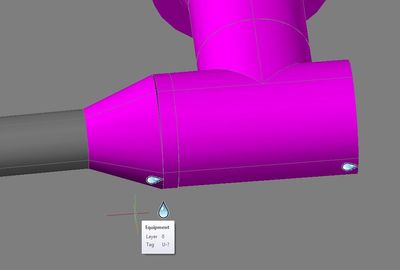

Hello; I have a similar problem when I erase a stub-end and then try to connect it again. It appears an error message. See attachment.

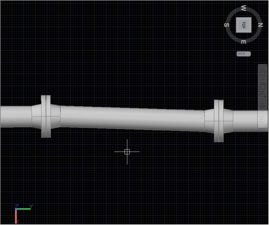

I know the connections have been improved from Plant 3D 2011 to 2012.
For example even if you have a WN flange that is offset by quite a bit, it should still connect.
These are offset both horizontally and vertically:
I haven't ran into any issues on re-connecting pipe after a fitting has been removed. Are the drawings you are working on created in Plant 3D 2012 or migrated from Plant 3D 2011?

Omar,
I checked the screen capture you attached and what is happening there is when you erase a stub-end the lap flange is still left there, disconected. So if you try to run pipe back to it the connection won't be made because the node for the lap flange is in the way of the other stub-end. If you erase the loose lap flange and re-connect to the stub-end it should make the connection again:
