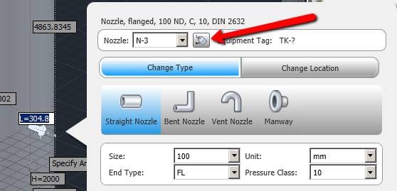

One more Issue for Creating Nozzle in the Equipment’s. I finalize the all nozzles in the equipment and get some new
Changes like (Re numbering the nozzle & Delete some of Nozzle how i can do that
Regards,
Ahmed Helal
If you Ctrl+Left Click the nozzle you should see a pencil icon. Click the pencil and you can edit the nozzle tags:
Could you "accept as solution" if this has solved the issue for you?
Dan
