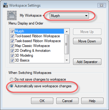

Hello! I have installed the 2012 Map software. I have selected the workspace that i want to use until 2013 is released Smiley Happy I went to the workspace customization settings, and selected my favorite workspace as the default & current. I apply/ok to leave customization dialog box. When i close out of the program entirely, and re-open the software, a different workspace is loaded during startup. How do i change my favorite workspace to automatically open during startup? Thank for your advice everyone

Murph_Map
in reply to: Anonymous
Check automatically save workspace changes perhaps.

Thanks murph for attempt. The dialog box you posted i have the same settings for 2012, but for some reason it doesn't stick. Also, after i closed the program and re-opened it, it says in the customization settings that my classic is the default workspace, but it's obviously not. . . maybe it's a glitch?

Sorry, but I couldn't understand exactly what you did to get it to work.
I have a customized workspace called Pats
Here is what I have tried that doesn't work.
I saved Drawing1.dwg with the Pats workspace.
I saved the template file map2d.dwt with Pats workspace
I went to the Customize User Interface window via Tools>Customize>Interface and right clicked on the Pats workspace and selected "Set Default"  then Apply
I closed everything then restarted Map12 and still did not get my desired Pats layout.
I tried rebooting, but Map2012 still opens up with the wrong workspace.
I have attached a screen shot of the CUI.
