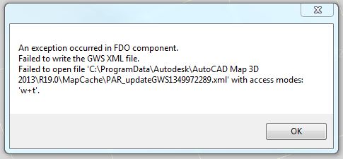

Can any one tell me what this mean?
Message 8 of 9
giser3
in reply to: tulio.paz

Alfred.NESWADBA
in reply to: giser3
why did you add a new message to an existing thread?
Your message is different to the one dicussed here before and tells you that you have not the necessary permissions to files/directory shown in the dialog.
