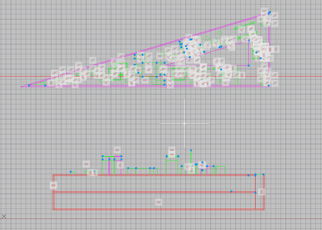

it's part of a larger drawing, but this is what I need to scale:

Almost all of objects in your drawing are constrained with each other (parametric constraints feature). So when you try to scale all objects in this drawing you (as I) should get this at the command prompt:
Command: SC
SCALE
Select objects: Specify opposite corner: 268 found
Select objects:
Specify base point:
Specify scale factor or [Copy/Reference]: 2
One or more constrained objects cannot be resolved.
In order to see all constraints you have to select "Constraint bars -> Show all" from Parametric menu.
In attached file I deleted all constraints, an now it is "scalable".

@09165021 wrote:
What did you do to delete all the constraints though? I went into parametrics, constraints bar, show all, but nothing changed on my drawing.
If you did this with drawing I've send to you - then there are no constraints in it, I already deleted them all.
If you will try to "Show all constraints" in your original drawing, then you should see:
