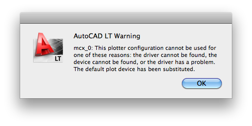

I went past the first msg (clicked OK) and clicked on PDF. When I clicked on view PDF in Preview, I got the attached msg. Clicking on OK i9n it did nothing: the msg stayed on the screen. I could not go back to Autocad. I had to go to another program just to be able to click Force Quit!
By the way, how/where/when is Autocad supposed to allow me to select what's going to be in the pdf?

OK,
I have managed to reproduce your error exactly (with "Force Quit" variant)
In order to repair this:
1. Quit AutoCAD
2. Start Terminal.app, copy this string to clipboard:
defaults write com.autodesk.autocadlt "HKEY_CURRENT_USER.SOFTWARE.AUTODESK.AUTOCAD LT.R18·2.PROFILES.<<UNNAMED PROFILE>>.GENERAL.PRINTERCONFIGDIR" "/Users/ab/Library/Application Support/Autodesk/roaming/AutoCAD LT 2012/R18.2/enu/plotters"
3. Paste it in Terminal and hit Return.
4. Verify with this command:
defaults read com.autodesk.autocadlt "HKEY_CURRENT_USER.SOFTWARE.AUTODESK.AUTOCAD LT.R18·2.PROFILES.<<UNNAMED PROFILE>>.GENERAL.PRINTERCONFIGDIR"
you should get:
5. If so - start AutoCAD and try to print or to open PDF in Preview
6. Let me know how it works.

Success!  The odd thing is that I still get the message that I posted first, the file called ACmsg.png.  After I get it, I click okay and now in the expanded print window I get the option to print Window.  That's all I need to do, i.e. I don't have a plotter but when I get to the stage of actually plotting 24x36 prints out just take the file to be plotted.
So, thank you so so much!  I really appreciate it.  But I am curious: the solution seems more technical than an AutoCAD user usually is. <g>   How did you figure that out?
