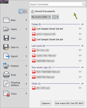

rhdins wrote:
So has anyone actually come up with a solution to this?
I tried clearing out the Profile.aws file and the sheet set files are still in my recent documents list.  And, if I sort by access date, all of the sheet set files are still there, it says I accessed them all today (I haven't)
Here is my example.
Yesterday, I had 3 or 4 drawings open, working on each of them
This morning I opened C3D, and saved the default empty drawing (as the junk33.dwg you can see here)
There is a DST that is says was accessed today (it wasn't), and 7 DST files under "older".
No mention of any of the 3-4 drawings I was in all day yesterday.
Since all I want to do is open the last drawing I was in yesterday, this is worthless to me.

Since that last post, I opened (using File>Open>Browse) a single drawing and worked in it until just a few minutes ago.  Then I saved, closed C3D, and restarted C3D.  Here is my "Recent" list now.
Not only does it not show the DWG file I just closed, but two of the three DST files it shows as "last used today" - were absolutely NOT accessed today, or even in the last few weeks for that matter.
