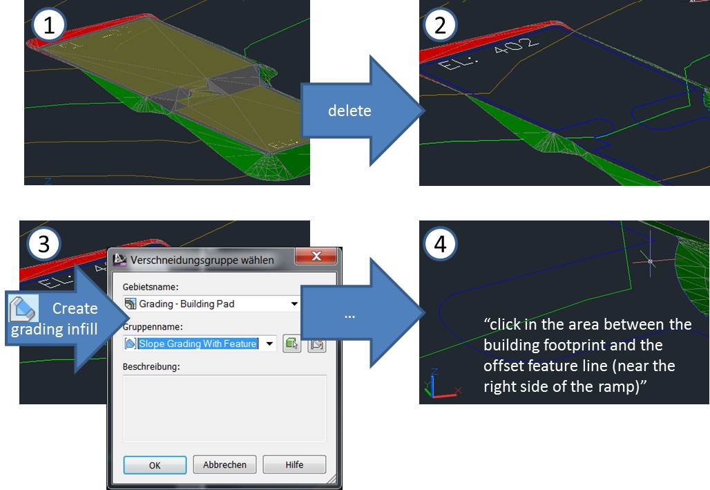

problem creating Infill grading - filling Holes
creating infill at the grading example from the civil 3d tutorial "filling holes in a grading" (grading-6.dwg) failes when selecting the area to fill. The command finshes whithout changing the model. There is no diamond symbol displayed.
any ideas what is going wrong? why i am not able to select the area?

thank you so far ... but I have no idea whats going wrong, maybe it is a simple stupig thing? I used the finished exercise drawing and deleted the infill, so I should have a good starting point to resolve. Doing the modifications again, I have the same problem - nothing happens. Please have a look.Bild1.jpg

ich hab's gerade mit 2013 probiert (Deinen Screenshots zu folgen) und das hat funktioniert. Welche Civil3D-Version hast Du?
I just tried it with 2013 and it worked (following the screenshots), what version of Civil3D do you have?

>> deleting by selecting via mouse and hitting the del-key
I did it the same way, and for me it is working (based on your uploaded 7-drawing.

look to the attached video, maybe you can find differences in the way we are doing/clicking/typing.

Message 16 of 18
Thanks a lot - this was very helpful.
It seems that it works only, when the selection of the infill areas are done in a top view (right side of the window)?
