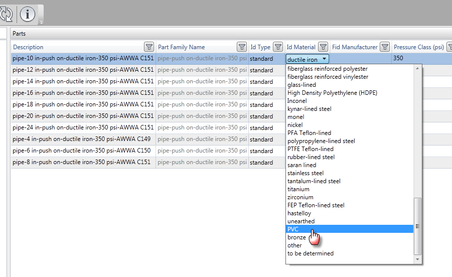

Being Civil's blog will help you with this.  Make sure you read the comments.  This is where you will find the Content Catalog Editor.  Link is below....
http://beingcivil.typepad.com/my_weblog/2012/04/introduction-to-the-pressure-pipes-catalog.html

ToddRogers-WPM
in reply to: bjones9975
Yes.  If you read Being Civil's blog, it tells you how to do this.  When you click on one of the pipes, to the right, you can change it from ductile iron, to your desired material.

ToddRogers-WPM
in reply to: Anonymous
If you change the pipe material to PVC...
Then rename the string to the left to say PVC instead of Ductile Iron...

in reply to: ToddRogers-WPM
Thanks Todd.  got it.    But is there any way to add a record rather than modify an existing one?
