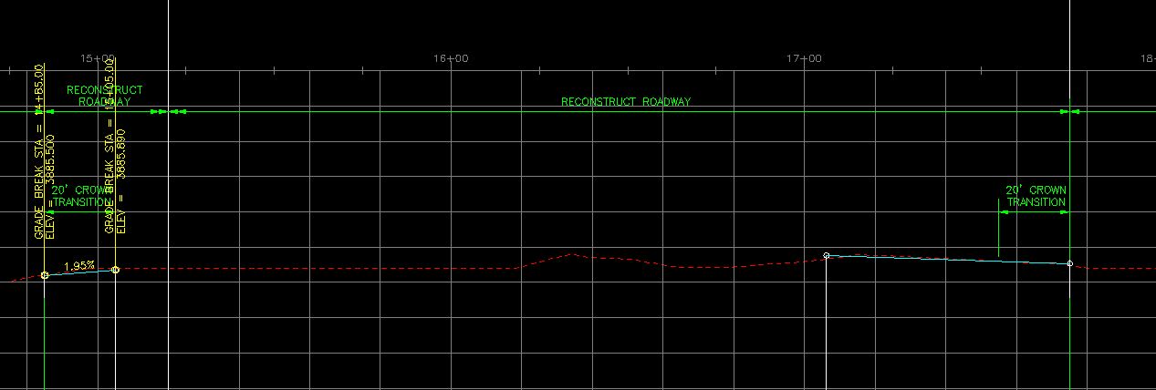

Does anybody know how (or if it is possible) to create a profile that contains mutliple segments. THe scenario I have is a proposed profile that ties to existing grade and then picks up again at existing grade some distance down the alignment.
The only way I can find to do this now is to create it all as one profile with no breaks and then go back and remove the profile segments in between the existing grad tie ins. Except when I remove a segment from my profile all of the labels beyond the first segment fo away.
In the past I have been creating multiple profiles but seeing as how long this surface alignment is and how many breaks in the proposed profile there are I would rather have just one proposed profile than several, especially when labeling existing/proposed elevations in the data band.
Here is an example before a segment is removed:
And here is an example after the segment was removed, the green labels are just polys and mtext not C3D entities

I use the Draw Tangents Without Curves or Drawing Tangents with Curves, either snapping to existing geometry or inputting using transparent command for Station/Elevation.
After creating a segment to which another does not connect, press enter, then press the Draw Tangents button again and start this segment somewhere else.

Edit the profile labels, add a line label style. All segments will be labeled.
The band labels work correctly as well, only showing elevations where there are no gaps in the profile.

Thank you Tim, I finally got back to this project and your method worked for me. I've definitely had a little trouble with the trial and error method in profile creation, mostly because of my frustrations with the Profile Layout Tools dialogue box. Everytime I make a mistake and try to go back it closes and go through the the profile creation process again. I've gotten a little better though.
The only issue I have now is some of my grade break labels not showing up as my profile progresses. Threre doesn't seem to be any particular scenario in which the aren't appearing. I've dug around in the label styles and can't quite pinpoint it.

It is probably not an issue.  You need to change the WEEDING distance in your Profile Labels.

Thank you Bill, turning the weeding factor down to 0.00 did work for some of the labels but not all. What's weird is that the labels that are still missing are all grade breaks that are relatively close to each other, for instance every time I meet existing grade there is a 20' pavement transition(no grade break labels). Now since setting the weeding factor to <20 didn't make those labels appear I wonder if there is separate weeding factor that limits labels by difference in grades due to the steepness of my transitions. Does anything come to mind?
