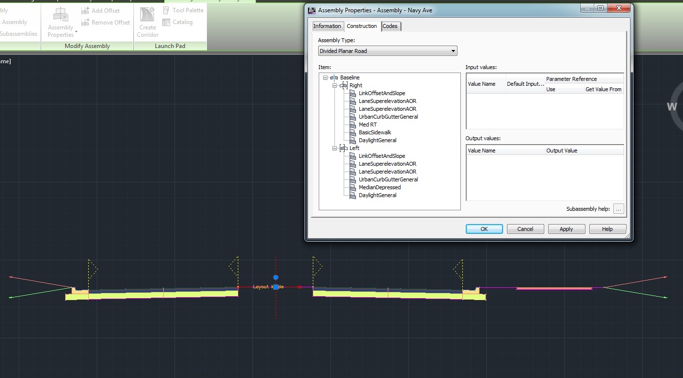

Hey, Thanks for everyone's help and ideas.
Here is what I ended up coming up with for my assembly. I used LinkOffset to offset the lanes and then a MarkedPoint on the right side so that my mark point would be on the edge of the right inside lane and my attach point is on the edge of the left inside lane.
My professor said only to put curb and gutter on outside but I have heard different opinions on this. Just curious to see what you'll think.
If anyone wants the file with the complete cooridor just let me know. I can't attach it because it is too large.
Thanks again, Nathan
Looks good. If you want the bonus marks though you'll want to delete the point and link codes from the two LinkOffsetAndSlope subs, and use the hide link option also. This will prevent the links from displaying in your sections or interfering with surfaces and quantities.
