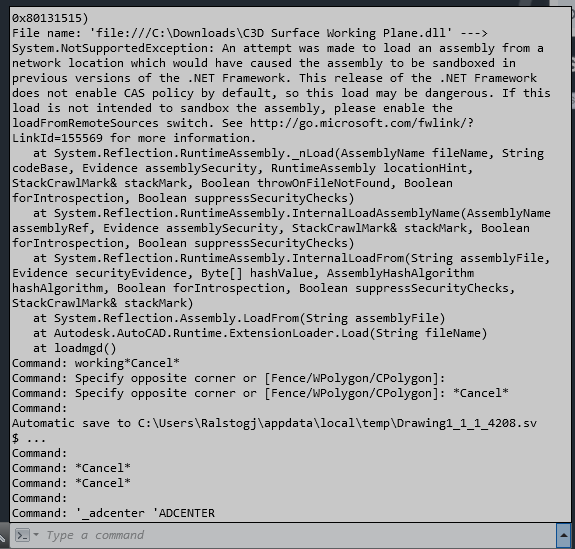

Gave up on porting the vba code to vb.net as not enough hours in the day. Anyway  I just updated my home laptop to 2013 and tried to load the C# assembly and got the attached error not sure what the issue is as loading from c drive. But first tried to loading from another drive maybe a restart and reload will get it working for me. Will try again tomorrow night.
In that case you can modify the file acad.exe.config (placed in the installation folder) and modify it / add the orange marked line:
<configuration>
  <startup useLegacyV2RuntimeActivationPolicy="true">
    <supportedRuntime version="v4.0"/>
  </startup>
<!--All assemblies in AutoCAD are fully trusted so there's no point generating publisher evidence-->
   <runtime>
	<loadFromRemoteSources enabled="true"/>
	<generatePublisherEvidence enabled="false"/>
   </runtime>
</configuration>
That's valid for all Framework 4 based applications.
- alfred -

ralstogj
in reply to: Jeff_M
Alfred
Thanks that did the trick
