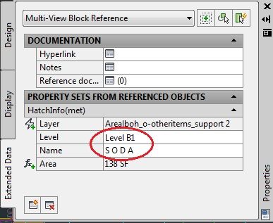

I'm using custom tags that read a couple property set definitions from hatch patterns(Name and Area).  I have the drawing with the hatch patterns referenced into a separate file where I add the tags.  When the tag is originally attached all works fine.  However, if I change the value of the Name in the property set definition the changes do not update.  If a change to the area occurs the update occurs automatically when the file is reloaded.   If I add another tag to the same hatch pattern the new values are read correctly.
(UPDATE)
I continued toying with this and I noticed something unusual. In the host file that contains the reference file, if the tag is selected the property set values of the hatch are displayed from the original fileUntitled.jpg.  However the lines for Level and Name are not shaded so I am able to edit them in the host file.  Not something I want to do unless the changes will go back to the referenced file.  This does not appear to happen.  But now updates from the original do not come through either.
I am unsure how I "turned on" this feature because when I recreated the host file from scratch.  The Property Sets from Referenced Objects are all shaded and uneditable.  Is there someway to turn this off and reset the drawing to automatically update from the reference file?

David_W_Koch
in reply to: FitzUS
It appears that your Name and Level properties are manual properties.  Since you are tagging Hatch objects (which are AutoCAD objects), the Property Set must be object-based.  I also am assuming that you are not working within the Project Browser/Project Navigator environment, as tagging through external references works somewhat differently (actually, better) there.
Outside of the Project Browser/Project Navigator environment, when tagging an object "through" an external reference, ACA will default to placing a property data override in the host file.  Initially, the properties in the override will be populated with data from the external file.  Automatic properties might stay in sync (not sure, have not tried this in a long time), but manual properties will definitely not stay in sync.  You can choose the location from where the property data will be pulled (if you tag one object at a time) at the time of tag placement, if you have not chosen to suppress the display of the Edit Property Set Data dialog.  You should see a Data source property at the top - if you use this to choose the externally referenced file, rather than the host file, then no override will be created in the host file, and changes to the base drawing should be reflected in a tag when the external reference is reloaded.
If there is an override, you will be able to edit the manual properties on the Properties palette in the host file, but these changes will not show up in the externally referenced file.  If there is no override, then manual the properties will be grayed out on the Properties palette.
After the fact, you can select the tag.  If an override is in place, on the Properties palette, on the Extended Data tab, you can select the Remove Property Sets tool in the lower left corner and remove the property override(s).  If an override is not in place, on the Properties palette, on the Extended Data tab, you can select the Edit referenced property set data tool, which is located on the right side of the PROPERTY SETS FROM REFERENCED OBJECTS header, and then choose the Add Property Sets tool in the lower left corner of the Edit Property Set Data dialog.
You can also manage property data overrides using the PROPERTYDATAEXT and PROPERTYDATABROWSE commands.  PROPERTYDATAEXT allows you to select an object (you can select the object nested in the external reference directly, if you like - if you do, you will be prompted to choose between the nested object(s) and the external reference) and then examine/edit the property data in the host and in the external reference file for that object.  PROPERTYDATABROWSE allows you to choose a Property Set Definition and then review the objects to which it is attached, adding or removing overrides in the host file (left column of toggles) and, where overrides are added, editing manual property values on the overrides.  If you want to verify that no overrides are set, or want to quickly remove all of them, PROPERTYDATABROWSE is the command to use.
When using Project Browser/Project Navigator, ACA "knows" that properties should live at the Construct level, and will not place overrides in the View files, but will place overrides at the Construct level when tagging an object that is part of an Element that has been externally referenced in a Construct.

FitzUS
in reply to: David_W_Koch
As always, thanks for coming to the rescue.
Yes, I am not using the Project Browser/Navigator enviroment. I've not really spent much time with it as it seemed to be only useful if doing a full blown project with ACA.  Perhaps there is a use for my little project measuring hatch areas and I can find the time to spend studying how it works.
I see how ACA assigns the property set definitions from the referenced file to the MVblocks in the host file.  Thanks for the tip on how to remove the overrides.  The PROPERTYDATABROWSE command works fine, but it seems easier just to select all MVBlocks and remove the property set definition in the Properties Palette.
I am inserting tags with leaders so I am doing them one at a time.  I would like to supress the PSD override in the host file if possible.  Is there a variable/setting by which I can do that?  If not, doing the removal with Property Palette works fine until I can master the Project Browser/Navigator enviroment.

David_W_Koch
in reply to: FitzUS
I am not aware of any setting that would make the default action on tagging to use the data from the object in the external reference (no override in host file).
