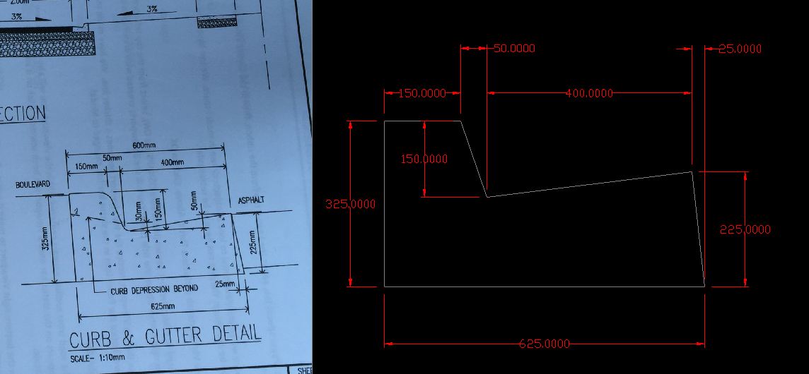

I have an assignment due on wed and I'm not very good at AutoCAD so any help would be appreciate it
One of the things I'm stuggling with is the curb on the right side I don't know to use fillet or arc and if so how ??
Any help hints is appreciate it

In autocad press F1. This brings up the help menu. Type FILLET. This will show you the help for the FILLET command. Alternatively type FILLET into autocad and see what happens (it starts the fillet command).

Fillet, arc or circle (trimmed) are all the same thing.
Can you attach the dwg of what you have completed so far?

The detail left out the radius for fillet  Smiley Mad

Yes but the problem is I don't know which line to offset, I'm not sure which two lines to fillet
I attached it I really dont know if i should offset if not then what should
i fillet for ?
i really appreciate the help. if you can try to explain it by steps how to
get it done that would be great help

Ommgg I'm sorry for late reply I was at work just starting to work on the assignment. I dont know how much to thank you!!! that was very simple and clearrrr you should def be teaching our class. and the radius i'm gonna put 30 and 50 for the top and i'll ask the prof
also, can you help me out with the top I'm not sure how to get all the different hatching.
can you also help  me out in the road cross section the one on top please

FWIW - In the Civil world this is commonly refered to as the "Construction Center Line".  It's much easier to design, and lay out a roadway during contruction if the centerline is defined along the crown of the pavement (axis of rotation).  Looking at this example it appears the 2m could be a typo (scale is off) and should be 4m instead.

CL can be that way in civil world, it didn't say CL of the pavement, it can be CL of the project alignment and the road widens from 2 lanes to 3 lanes.
sorry so our prof has made couple mistakes apparently the road width is wrong and the CL is nothing its just the letter C & L inside of each other. Thank you all for the help. If anyone has any recommendation for videos or anything to practice and become good at autocad please post I really want to become professional at it but I don’t seem to grasp it very easily!
