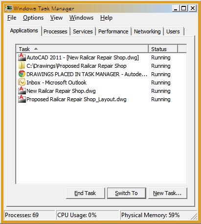

We have a new 64 bit box running 32bit AutoCAD 2011 with Windows 7, 8 Meg of RAM.  When we open a drawing all is fine, but when we open a second drawing, it places these drawings in the task manager.  We can go in and delete the task, and the drawing still remains.
Apart from the above, we are also Using Microvellum 6.7 (32 bit) and when we call up product prompts or other things, it puts them immediatley in the background and we have to go thru task bar to get it instead of it placing it on top of the drawing. Until we went to AutoCAD 2011 we did not have these issues.  Microvellum says it is a AutoCAD issue.
Any options to help correct these things would be deeply appreciated.

I am talking about the Windows Task Manager. You can find it easiest by Right-Click on the Windows Task Bar.

I have 2 drawings open SDI=0

That's very normal in Win7 and not anything unique to AutoCAD: start MSWord or MSExcel and more than one document in each and you will see the same exact thing. There is nothing to 'fix'.
Not sure any of it has to do with AutoCAD stealing focus from your other add-on program: you may simply be just removing AutoCAd from being in front (you can right-click in Task Manager and bring the other program to the front instead).
Is your mouse movement over other program windows triggering which app is in front by chance?
