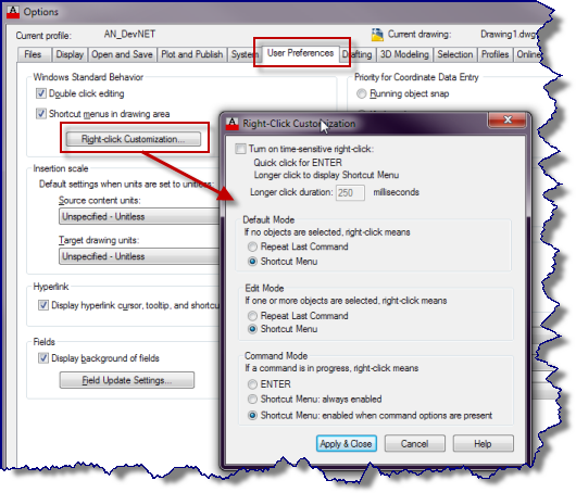

goto _OPTIONS and verify the right-click settings
Also: if the objects get's deselected there would be some message in the commandline, isn't there any?

have you compared my screenshot and yours?
You have for the option "Edit Mode" ("If one or more objects are selected, right click means") ==> Repeat Last Command ... and not (like I have) Shortcut Menu

I thought I have checked it. My Right-Click configuration short cut menu was not checked. Once I checked it - It is wooking. My question is how it got chaaged? Is it possible that when I receive drawings from other people that drawing causes the change?
