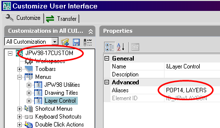

For this example, this menu is an enterprise to the main ACAD.cui.
POP14 will show when the editor is started, however if I name this to POP140, it will not show and
I will use the following macro to make it display: (menucmd "P16=+JPW98-17CUSTOM.LAYERS")
