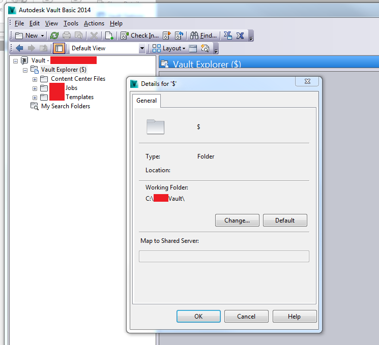

Hi all,
I hope this hasnt been asked too many times, I did do a search but couldnt find much.
Im my company I am trying to impliment Vault 2014 having previously never used vault here (I have at other companies). I have got it installed and working and I can check files in and out as a test. Cleared the vault so it is empty and ready for our "files" to be uploaded. I am still at a testing stage but want to get a well working folder structure
I was hopeing to have the following structure but am coming into some difficulties with the templates fodler.
Folder Structure
I want and think the templates folder has to be outwith the root folder for jobs. However when I try to upload our Drawing, Part etc template files i am unable to have them outwith the jobs folder, it auto checks them in to there. Thinking i could do that then change the template location in the project file to this vault wont let me as its in the jobs folder.
Can anyone with more experience help me out in being able to use the above folder structure? It would be greatly appreciated.

Basically we have never used vault in this company so I am trying to get everything setup. I am wanting to set up a single project file system with all jobs being new folders under the "jobs" main folder. I have setup the above folder structure on my C: drive and have the below structure setup in the Vault, with "Vault Explorer ($) set as the root folder.
Vault Folder Structure
As mentioned in my first post, I am struggling to understand how to store our drawing,parts etc template files. As it wont let me upload them to the "templates" folder above, it will check it into a new folder in the "jobs" folder but then it wont let me point the templates location in the project file into that folder in "Jobs". Is my only option to have the templates stored on our server as we do currently and not how them within the Vault?
I should mention that I am easily able to check in a "Test Job" into the Jobs folder, thats no problem. Its just how I manage the templates.

To further elaborate. I get this error message.
Error Msg
Now I can check these Drawing Template files into the working folder no problem but this is where I enter a conflict as you are unable to set the "Templates Location" within the project file to a folder withing the "Workspace" so I cant link the "templates Folder" up with the project file.
