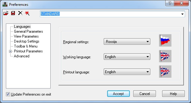

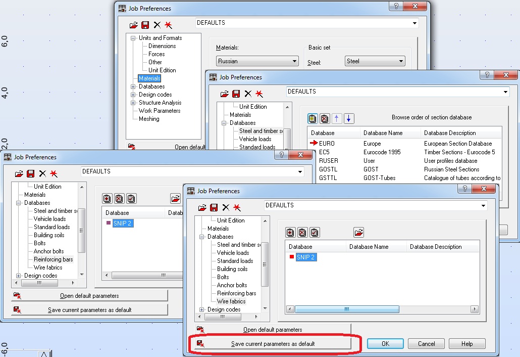

Rafal.Gaweda
in reply to: huyxp
Robot:
Use predefined set:
or adjust job prefences by your own and save as a defaults (example below, set codes additionally)
ASD:
use predefined
or set Job Preferences by your own and save as dwt file and select this saved dwt file in Preferences
