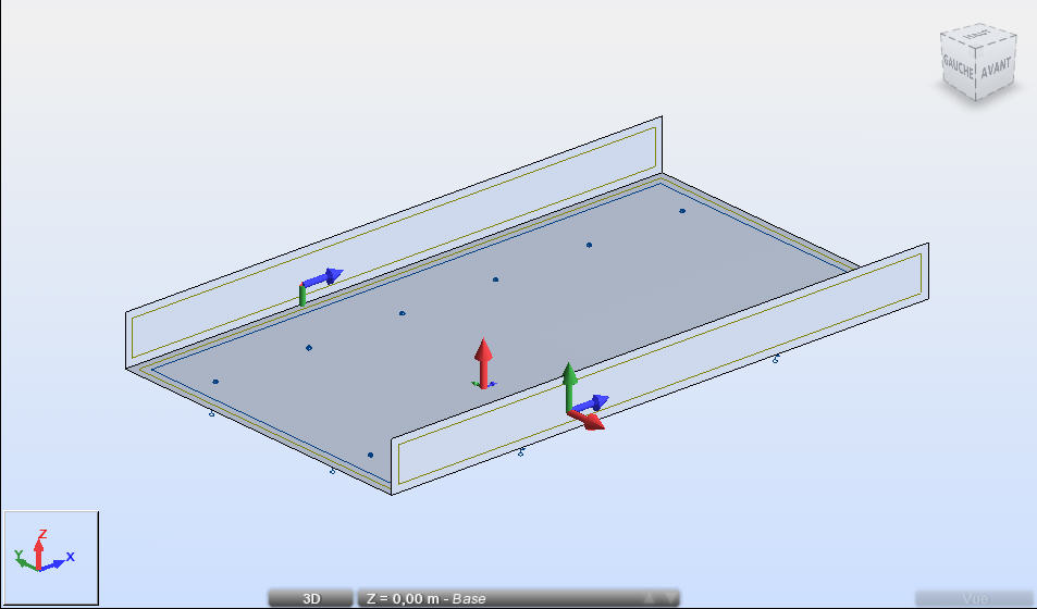

I created a model of a slab placed and anchored in some places on a rigid support (look at the picture below).
With regard to the supports, I used two types of supports at the bottom of this slab.
1)      Punctual pinned supports (nodes: 6 to 16)
2)      Planar elastic supports (look at the definition below). These supports make it possible to block the deformation towards UZ- but to authorize uplift towards UZ+.
The loads applied are as follows:
1)      Dead load
2)      Heat gradients ±80°C/m
the combinations are made as follows:
1)      ULS : 1.35*G+1.5*T
2)      SLS : 1*G+1*T
But after calculation, I find that the bending moments in ULS and SLS are almost similars, it is not logical because normally these two bending moments have a ratio of 1.5. I do not know why
However, after having replaced the planar elastic supports by planar simple supports or simply removed the planar elastic supports, I find the normal results as follow
Can you bring an answer to me? I add my small model in the enclosure
 Thank you in advance.
Yan

Running your example with the current version of Robot (2013) I can see that this situation has been corrected.

The solution for the older versions is to create a new simple load cases with loads of magnitudes as in the combination it is going to replace. See the attached picture.

1. Set the temperature load as the first load case (with the lowest number)
2. Set it as the staring case for other cases
Mind that you can do this for one temperature load at the time so you need to have two separate models for + and - gradients.

Hello, I still have a  question concerning the application of the heat gradients in the model.
I created a model of a railway slab with two walls anti-derailment of the train (see figure below)
I applied heat gradients to these three panels (1 slab + 2 walls). (see figure below).
But the client says that the application of the heat gradients on the two walls is not correct. Because my model take into account of the application of the heat gradients according to the diagram n°1, but in fact, the way that the heat gradients are applied in the structure must be like the diagram n°2.
I know that the ROBOT applies the heat gradient according to the thickness of the panel. So, is there a solution where the heat gradient can be applied to the wall in the vertical direction like the diagram n°2 (local axis Y in the model)?
In fact, I found a solution where I can create three horizontal slabs with various thicknesses, but in addition to the heat gradients, there is still a linear shock applied to the top of the wall qui will create the bending moments at the bottom of walls (see figure below). If I do like this, the bending moments will not be produced. This solution is not thus good, I think.
