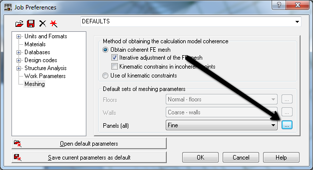

Hi
Is it possible to save meshing options so I don't need to change them everytime?
In addition, how can I turn of layers from a dwg file after I have imported it?
Thanks in advance.
Regards
Peder
Set your default meshing parameters in Job Preferences and save this set under a new name. Then you can use it for new projects.

I want to save the settings illustrated in the view below:
pevelor
in reply to: pevelor
Thanks for your help. I figuered it out now.
