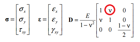

In RSA you would need to change values in the fields that are grayed out and therefore not accessible (the request for making them editable has been sent the development team). The workaround is to use the user defined orthotropy instead.

may I ask, the label of f12 and K12 is not correct then, because that is not consistant with shell terminology f12 and k12?
and in other words, what is the effect of changing f12 and k12 on the results then?
Thank again, much appreciated!
Message 10 of 14
Artur.Kosakowski
in reply to: mgaafar
The influence of strain in the direction X on stress in the direction Y.
