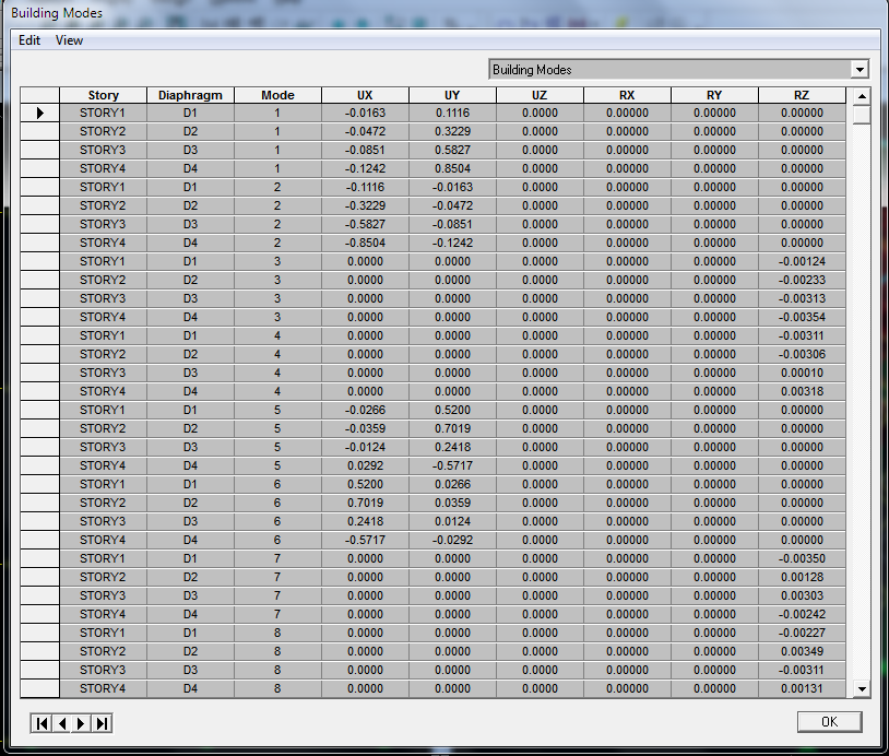

I'm using Robot for a 63 story building. My Boss ask me to generate the X and Y components of the Mode Shape displacement (unitless) for every floor similar to the attached table from ETABS. Can we do it in Robot? This data wil be used for wind tunnel test. Thanks

trandtrung00
in reply to: djan0521
Hi Dian021 ,I had the same problem but i could not find the result as you found.Can you show me where is it in the Robot program or just post some picture of it.
Thank regard !!
This is the result i hae in Etabs but I can't find it In Robot .Please help !

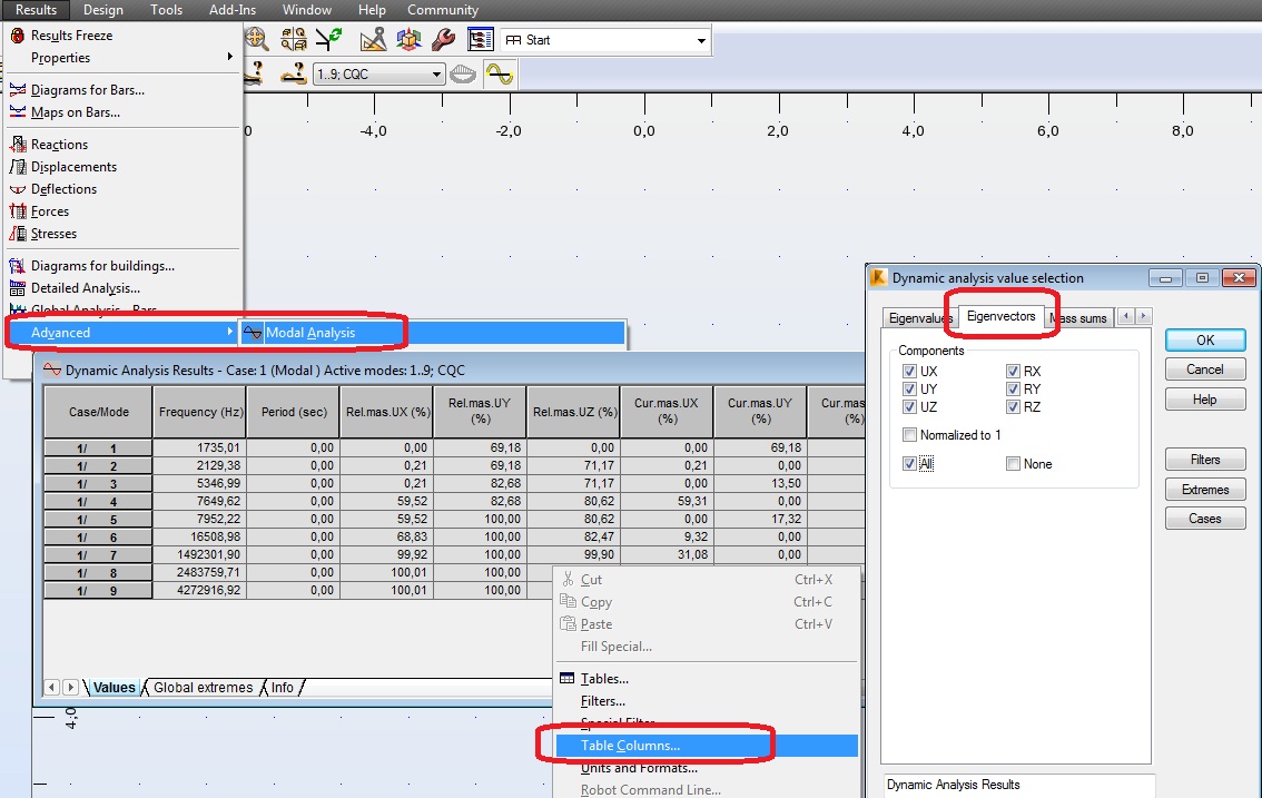

 The displacement values of any node of the structure corresponding to a given eigenshape can be viewed when choosing the option “Deformations” in the “Diagrams for buildings” (see attached). They should also be displayed in a table form.
  Keep in mind that the values that are viewed with the above option are the total ones (i.e the square root of the sum of squares of each component) and that they are not normalized to 1.

Rafal.Gaweda
in reply to: trandtrung00
Every node belonging to each diaphragm in your model will have the same UX UY so take any of them: http://screencast.com/t/47Nmw6Ti
