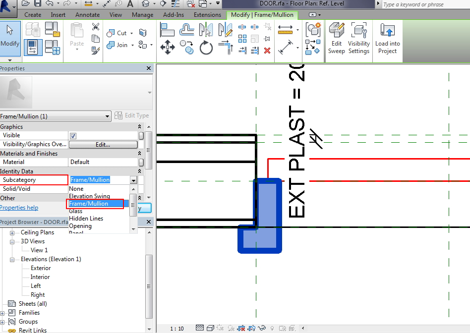

I have a frame created as a sweep in a door family - but for some reason it always shows in blue linework, even when not selected.
Any idea if this is to highlight an error or other issue with the model ?
It seems to have appeared after I deleted the cut opening outline and replaced it with a couple of Void Extrusions (to allow me to control the wrap of the plaster finish and not have it impact on the structural opening size).
The frame does sit within an extrusion void, but it is not selected to cut it.
Martin

I am not sure if this could be the cause , but you can try to check the following:
  1. select the frame - in Properties>Subcategory>select Frame/Mullion -now Revit knows what the sweep is......

Thanks Constantin,
no joy on that one, I had tried looking at object styles, but frames are set to show green rather than blue. Sub-category had defaulted to <none> previously too.
There could be an issue somewhere in the file too. Previously I was able to switch a nested family (door leafs) via <Family Type>, but it now throws out any number of 'unable to satisfy constraint' errors when I try.
Looks like something has gone a bit up-the-left.

If in Object Styles>Model Objects>Doors> Line Color- change to black it works .....I do not understand....in your computer is not the same acting?
Your Door has no allocated subcategories. It'good to allocate them in order to can use different materials for frame and door lead,etc

Thanks Constantin, that solved the blue colour for the frame element. Still not sure why it flipped over to blue, and still no wiser to why the adjacent void extrusion shows in orange when I select the frame, maybe some quirk with Revit.
As per your suggestion, I've been looking into subcategories. I can set them OK with elements in the main Host Family (Which is a Door Category), but I've set the door leafs (panels) as 'Metric Generic' category type, so I can't assign subcategories from the standard Door Category. I didn't set the door panels as 'Doors' as I read that it can interfere with scheduling (ie both the nested door leaf and the host door will appear on the schedule - 2 entries where there should only be 1 - unless this can be controlled by filters ?).
