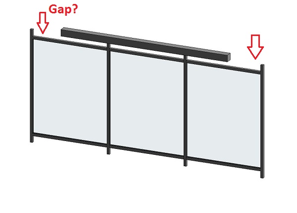

I'm having some trouble understand how I go about adjusting the glass panel downloaded from Seek.
What I'm trying to do is add a baluster with a plain glass planel. I'd like it to have a 10mm gap on both sides, no gap at the top/bottom.
Here is a snapshot of the plan view where it will be sitting
I was thinking 2x panels for the 1986 side, and 3x panels on the 2932 side, so roughly 900mm wide?
First thing I did was open the Baluster Panel - Glass family which I downloaded from Autodesk Seek and clicked on family type - new. I adjusted the width to 900mm and gave it a side gap of 10mm, then loaded it back in my project.
I then selected the default railing in my section and duplicated it.
Then I clicked on edit type - Baluster Placement, and changed the baluster type to the 900mm one I created within the family.
After apply all the settings, my glass baluster looks like this. I guess I'm missing or not understanding the gap or width settings?
I would like 3x panels on this side of the path and 2x panels on the other.
Any help is greatly appreciate.

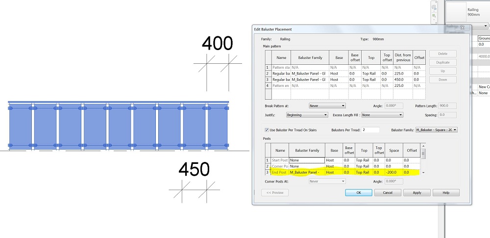

Let me try and simplify this.
I've drawn a 1000mm railing path, and loaded the M_Baluster Panel - Glass w Brackets : 450mm w 25mm Gap as the panel. I've set the Dist. From previous to 450.0, and set all posts to non.
From what I can see in the finished railing, there seems to be a 225 gap from the beginning of the railing.
How do I set this to be 0?

The logic behind these patterns made of glass panels is kind of strange. The origin of the panels is the center reference plane, but the pattern needs to be "pushed" one half to the side, with the offset for the pattern end. At the end, the sum of the pattern needs to be equal to 2 panels. If the length of the railing is not a multple of the pattern, it can be fixed with the Excess length fill option. See if this illustration helps you understand the logic.

About your new question, perhaps you could set the railing to be a multiple of 900 mm, so that there are is not a leftover, and then make a new segment of railing with a narrower panel. Or, you could adjust the width of the current panel so that the length of the railing is a multiple of that width.

Oh I see what your saying.... so in otherwords if the end panel is 400mm wide (being the fill gap), I create a 400mm type of that panel in the family, then add that as a end post and offset my space -200mm
