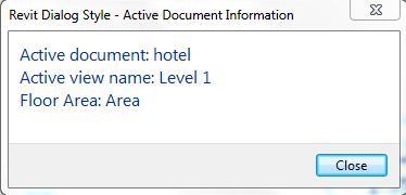

Hi again,
i hv 1 more question..<for now>..Smiley Tongue
how to get area value to be read in task dialog box..
my codes are as below:

the highlighted should read the area value..right? or not? the result that i get shown below:
helpSmiley Sad
thx in advanced..
-Nik-

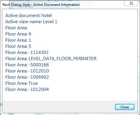

nope..still not working...not sure how to solve this..i did try so many way to get the area value..
here are my code:

TaskDialog.Show("Active Document Information",
"Active document: " + activedoc.Title + "\n"
+ "Active view name: " + activedoc.ActiveView.Name + "\n"
+ "Floor Area: " + activedoc.ActiveView.Level + "\n"
+ "Floor Area: " + activedoc.FloorTypes.Size + "\n"
+ "Floor Area: " + iarea1 + "\n"
+ "Floor Area: " + iarea2 + "\n"
+ "Floor Area: " + iarea3 + "\n"
+ "Floor Area: " + area4 + "\n"
+ "Floor Area: " + iarea5 + "\n"
+ "Floor Area: " + iarea6 + "\n"
+ "Floor Area: " + iarea7 + "\n"
+ "Floor Area: " + iarea);
return Result.Succeeded;
this is what i get:
not sure what the numbers mean...
thx in advanced
-nik-
Message 9 of 12
ollikat
in reply to: nik.mazreen
Maybe we should first make sure what are you trying to do. Are you trying to get a area (square meters etc) of some floor. Or is it something else that you want?
Message 10 of 12
nik.mazreen
in reply to: ollikat
what im trying to do is that i try to make my taskdialog box to read the area of the floor of my model (hv 3 level).  then i want to transfer this value to either excel/pdf/word..i know in revit there is a tool called Export to export the properties of the model in to csv files..but i want to make it as a new tool that only read the specific value such as area to be export to my report that i've created in excel/pdf/word...is it posibble to do that?
Message 11 of 12
ollikat
I don't know about excel and stuff. But the way you try to get the floor area is not correct. When you have got the floor element etc. which has this area parameter, then you can use it's Parameter property (inherited from Element) and read the value from the parametr you got (AsDouble(), AsString() etc...). What you are now doing is you are printing the values of enumerations.
Message 12 of 12
nik.mazreen
Hi..
It has been a while...now i'm able to transfer some of the info from the actived revit file into the pdf format...but still i could not get the area value of the model from actived revit file into pdf format..maybe because i dont really understand the parameter used in the revit...
can anyone show me which parameter should i use to call out area value?i've tried BuiltInParameter..but it doesn't seem right...hurmmm~~help...
Thx...
-Nik-
