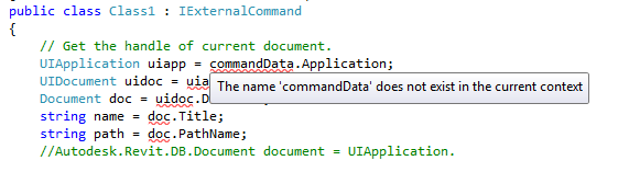

I'm trying to get the name of the active document. I'm looking at the API developer's guide and at the bottom of the page at the following link, there is an example involving something similar.
[url=http://help.autodesk.com/view/RVT/2014/ENU/?guid=GUID-5282B7DB-E7A7-465B-A925-53BBBC3CC8D7]Help[/url...
Following is a snippet from that example. In my example, I'm not passing the application variable. The image shows a screenshot of what I see in VS2010 -- I don't see ActiveDocument as a child of UIApplication.

Dear Don,
You can navigate to the active document name from the command data argument provided to the Execute method like this:
  UIApplication uiapp = commandData.Application;
  UIDocument uidoc = uiapp.ActiveUIDocument;
  Document doc = uidoc.Document;
  string name = doc.Title;
  string path = doc.PathName;
Please note that the title is not set on an unsaved document.

Thanks but this still gives errors.

jeremytammik
in reply to: doni49
Please work through the getting started material:
http://thebuildingcoder.typepad.com/blog/about-the-author.html#2
You have not defined an external command.

I think I have done that.  I was just showing the portion of code presenting the error.

jeremytammik
in reply to: doni49
No you have not.
You have defined a class derived from the IExternalCommand interface.
You have however not defined its Execute method.
Please work through the getting started material to see how to implement the external command interface.

doni49
in reply to: jeremytammik
Ok thanks.  I found out that I DID have the external command in the code -- but it was BELOW the code that I was using to get the file name.
I rearranged the code and got it working now.
