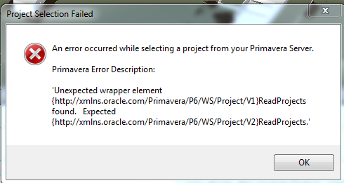

I would like to know if Navisworks Manage 2013 Timeliner is compatible with Primavera P6 EPPM 8.2?
I get the following error message and trying to add the Timeliner data source to P6 8.0 web services:Capture.PNG
From what I am reading here: http://navis-infocenter.blogspot.com/2012/09/timeliner-with-primavera-web-service.html Timeliner is compatible with verison 8.0 but not 8.2? Can this be confirmed and are there any plans for supporting the latest version?

Development is aware of this and hopefully it will be resolved in a future release. Thanks for posting.
