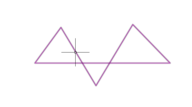

I'm trying to split a polyline that have some intersection points at its intersection points. So, if a polyline have two self intersection point, then it will become three different polyline. I attach the example of a polyline that I want to split. I wonder, does the get split curve method can help me to do this ? or any other idea how can I do this ?

Yes, GetSplitCurves() could be useful as it can split the polyline, however you have to provide the additional logic that will be able to turn the polyline you attached into 3 closed loop polylines. Depending on which vertex is the start/end point of the polyline you'll get different results.
Another thing that might be useful for you to know is that there is a boundary tracing function available since AutoCAD 2011. In AutoCAD 2011 only in the ARX API (I think), but in 2012 it is also available under Editor.TraceBoundary(). If you specify a point that fals inside a loop then it will give you the poly loop around that point. In previous versions you could use the -BOUNDARY command instead.
In both cases though first you'd probably have to figure out the intersection points. So you would need to iterate through each segment of the poly and try to intersect it with all the other segments. Depending on the return value of Polyline.GetSegmentType() you would need to call either GetLineSegmentAt or GetArcSegmentAt. These segments then provide an IntersectWith function that you can use.

Message 7 of 10
BKSpurgeon
I would add the following to Adam's post: http://through-the-interface.typepad.com/through_the_interface/2010/06/tracing-a-boundary-defined-by...
which is a good example of the trace boundary implmentation.

Message 9 of 10
silke.foernzler
The above algorithm for splitting polylines works quite nice... until the polyline contains arc segments that will be splitted.
To handle this problem, just add the following lines of code after the call to 'IntersectWith()':
for (int k = intsPnts.Count-1; k >= 0; k--)
   Point3d pt = intsPnts[k];
   if (FuzzyEquals(pt, segi.StartPoint) || FuzzyEquals(pt, segi.EndPoint))
      intsPnts.RemoveAt(k);

Message 10 of 10
why so complicated? just use "bo" (boundary) command, use generate pline and pick a point and pick inner points in every polygon you want a region.
