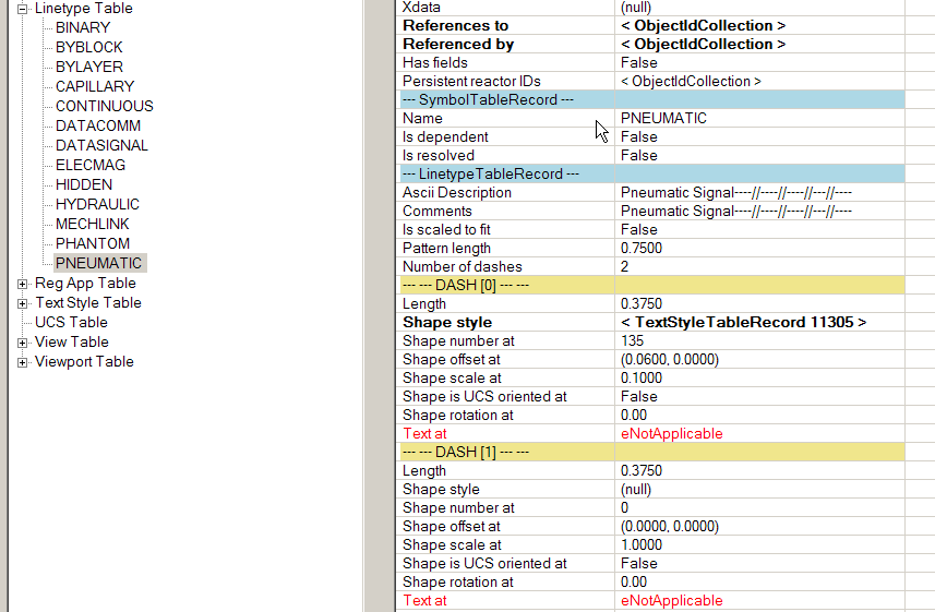

How would I Reload a linetype... the linetype already exists in the drawing...
But I want to update the linetype defintition.
This doesn't work.
I need to open the linetyperecord... but what do I use to reload or re-define the linetablerecord.
	Dim db As Database = ActiveDrawing.Database
			Dim ed As Editor = editor
			Const filename As String = "SFR_LINETYPES.lin"
            Try
				Dim path As String = HostApplicationServices.Current.FindFile(filename, db, FindFileHint.Default)
				db.LoadLineTypeFile("*", path)

Those solutions don't work.
I need to delete the linetype and then reimport or re-define it completely.
For whatever reason It's not working.

using art's reference above, viru says that a drawing's line type definitions get updated when its .lin file is loaded (as you show in your post). therefore as long as your drawing continues to use its .lin file, the line type definition in the .lin file has to be changed (presuming the line type name stays the same)

Hallex
If CommanfFlags is set to Session
you have use LockDocument, i.e.:
        [CommandMethod("relaodLinetype", CommandFlags.Session)]
        public static void relaodLinetype()
            // Set full path of .LIN file herer:
            string linfile = @"C:\Test\SFR_LINETYPES.lin";
            DocumentCollection docManager = Autodesk.AutoCAD.ApplicationServices.Application.DocumentManager;
            Database db = docManager.MdiActiveDocument.Database;
            using (DocumentLock doclock = docManager.MdiActiveDocument.LockDocument())
                Transaction trans = db.TransactionManager.StartTransaction();
                bool bReload = false;
                using (trans)
                    LinetypeTable table = trans.GetObject(db.LinetypeTableId, OpenMode.ForRead) as LinetypeTable;
                    if (table.Has("CENTER"))
                        bReload = true;
                System.Int16 fileDia = (System.Int16)
                    Autodesk.AutoCAD.ApplicationServices.Application.GetSystemVariable("FILEDIA");
                Autodesk.AutoCAD.ApplicationServices.Application.SetSystemVariable("FILEDIA", 0);
                //reload using linetype command...
                Object acadObject = Autodesk.AutoCAD.ApplicationServices.Application.AcadApplication;
                object ActiveDocument =
                    acadObject.GetType().InvokeMember("ActiveDocument", System.Reflection.BindingFlags.GetProperty, null, acadObject, null);
                object[] dataArry = new object[1];
                if (bReload)
                    dataArry[0] = "-linetype Load CENTER\n" + linfile + "\nYes\n ";
                else
                    dataArry[0] = "-linetype Load CENTER\nacad.lin\n ";
                ActiveDocument.GetType().InvokeMember(
                            "SendCommand", System.Reflection.BindingFlags.InvokeMethod, null, ActiveDocument, dataArry);
                Autodesk.AutoCAD.ApplicationServices.Application.SetSystemVariable("FILEDIA", fileDia);

Many Thanks Hallex, as you've helped me when I was in a pickle before.
Having some success here! Smiley Very Happy
It works!
