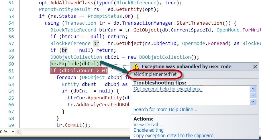

    If block has Polyline3d and scaled uniformly (e.g. Xscale == Yscale == Zscale) - block exploded  as expected, but if it scaled nonuniformly than:
    So with method Explode you can not explode nonuniformly scaled block with Polyline3d.

    But I wonder why its not implemented :smileysurprised:
    What entities support a non-uniform scale matrix?
