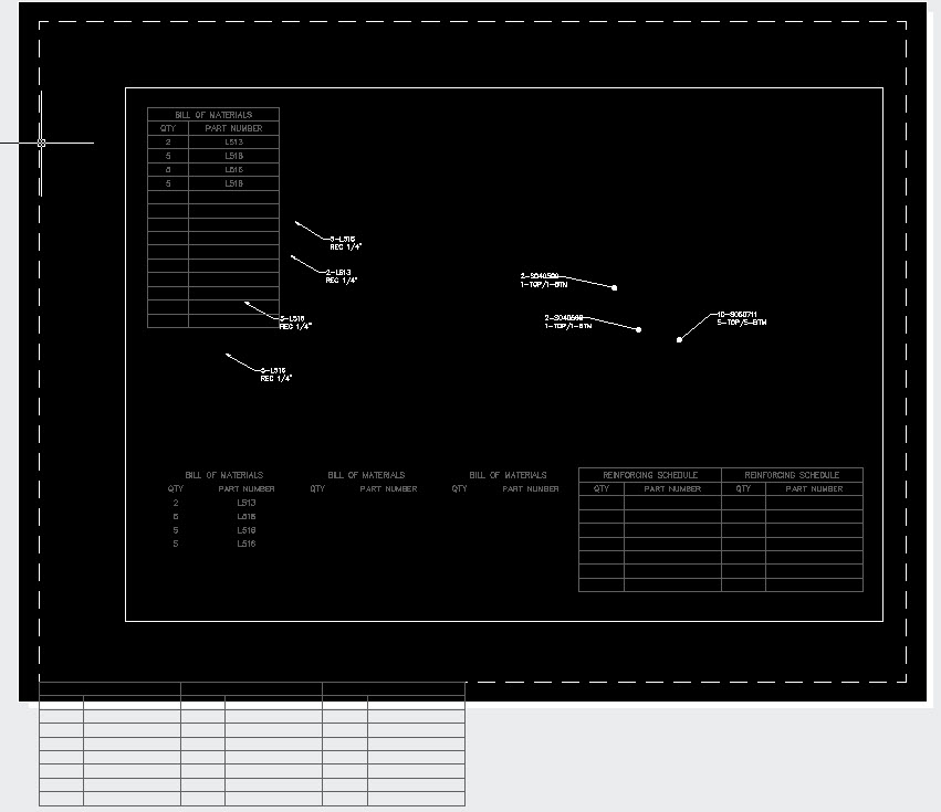

Hi All,
I am wondering if someone can help me figure out what I am doing wrong.  I have code that reads mleader info from a drawing and inputs the data into a table.  Before it does that, the code unlocks the layer that the table is on.  After I am done editing the table, I relock the layer the table is on.  For some reason, when I relock the layer, the boudary lines of the table all shift.  The data stays in the proper location (see attached image).
I am still able to edit the table (after unlocking the layer) and if I close the drawing and reopen it, the table goes back to normal.
If I comment out the code that I have to lock the table, the problem does not occur.
Here is my code:

Thanks for calling me out on my poor coding abilities! Smiley Happy  I need all the advice I can get as I still have a TON to learn!  Most of the code I write is loosley based on an examples I find in books, online or from the forums.
I did not realize that you could force objects on locked layers to be opened, hence the reason I was unlocking the layer first.  I have re-written the code to no longer touch the layers.  Now I simply unlock the table with an overload of GetObjects.
After running the code again, I am unfortuantely still seeing the same table behaviour.  A regen does not bring it back and switching tile mode in my code does not bring it back.  The only thing that seems to correct it is closing and reopening the drawing.  Am I doing something wrong in the way I am editing the table?  If the layer is not locked when the code is run, then the problem does not occur.
Here is my full code:

I ran your code and dwg in AutoCAD 2012 and I see what you mean. When the layer is locked the table cell borders go weird!!
I tried a number of different techniques to try to regenerate the table but none seemed to work. I tried to unlock the layer within the command, change the table, and then re-lock the layer. Still to no avail.
Welcome to strange happenings in the world of the AutoCAD API Smiley Very Happy
Below is my suggested workaround. Although not ideal, it does work!
The approach here is to create seperate commands to do the following:
1. Unlock the layer if it is locked.
2. Update the table.
3. Re-lock the layer if it was originally locked.

I had another look and this issue also seems to be related to how your table and its table style is formatted.
Please refer to the attached ModifiedTest.dwg (AutoCAD 2010 dwg format).
I added a new ECDT_NW-BillofMaterials table to the locked layer using the TABLE command. I left the 'Insert Table' dialog defaults and hit OK.. Refer to the attached InsertTableDialog.jpg image which shows the default settings I used.
Now when I update the tables (with the layer locked), the one I inserted from scratch works fine but the one you had loses its borders. Refer to the attached Screenshot.jpg image which shows the results.
Might be worth spending some time looking into your table and the table style you're using.
Cheers,
