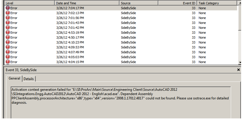

    Error While opening autocad using process.start
    335 Views, 3 Replies
    03-26-2012 05:07 AM
    Error:
    Activation context generation failed for "E:\SI\ProArc\Main\Source\Engineering Client\Source\AutoCAD 2012\SI.Integrations.Engg.AutoCAD2012\AutoCAD 2012 - English\acad.exe". Dependent Assembly PPClientAssembly,processorArchitecture="x86",type="x64",version="2008.1.17012.4817" could not be found. Please use sxstrace.exe for detailed diagnosis.
    Please help me on this issue
    Regards,
    Raman

    Re: Error While opening autocad using process.start
    03-26-2012 06:33 AM in reply to: RamanSBV
    Please post your code on how you are doing the process.start.
    Any reason why you would use this method to start AutoCAD?
    03-26-2012 06:38 AM in reply to: Mike.Wohletz
    Error while opening autocad exe
    Just i am clicking on acad.exe and i am getting above error.
    and In Event Viewer It is showing as
    Regards,
    Raman
    03-26-2012 06:46 AM in reply to: RamanSBV
    It looks to me like you are trying to start the Acad.exe from a location other than where it was installed. I think you should be starting this from the AutoCAD subdirectory in  C:\Program Files\Autodesk unless you have installed this in some other location.
