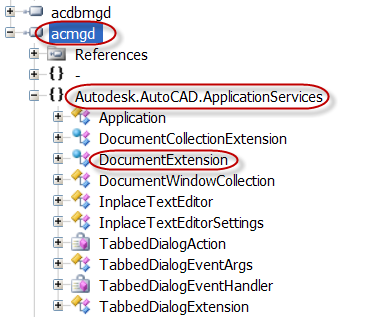

Alexander.Rivilis
In AutoCAD 2013 class Autodesk.AutoCAD.ApplicationServices.DocumentExtension is in acmgd.dll
