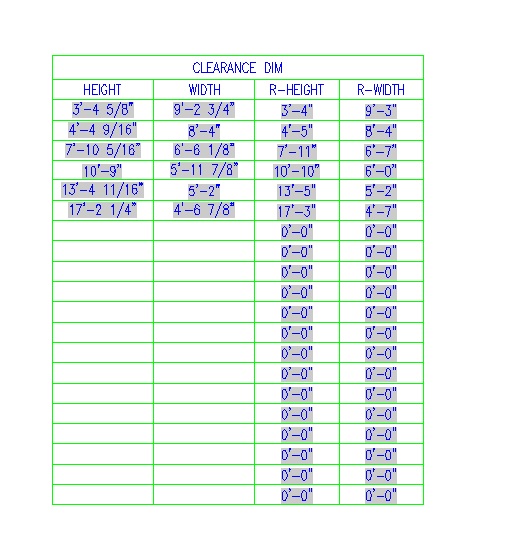

Autodesk.AutoCAD.DatabaseServices.Table random FlushGraphics error
Error,
System.Runtime.InteropServices.SEHException (0x80004005): External component has thrown an exception.
   at Autodesk.AutoCAD.ApplicationServices.TransactionManager.FlushGraphics()
also cites a position in the code where i'm calling transaction.commit.
This happens once in a while, but not all the time.  In this code I'm not creating a new table, just manipulating one the user selected.  This routine (probably already posted here once before) creates fields in 2 columns that link to selected dimensions' measurement values, and two other columns with formula fields that round up or down from the first two columns as logically necessary.
My workaround so far, has been to regen, save the file, close and open it again.  The second time around everything works ok.  I have noticed this happen more often when I add rows to a table manually (but not when I remove them).  Another unknown quirk is when the code finished with extra rows still in the table, it wipes out the data in the next 3 cells following the last row used, but I don't think that last one is directly related.  I've had this issue with AutoCAD table .net api since 2011-13.
Code available upon request (lots of fines and related files).
Can somebody help me resolve this flush graphics error?

Well, I can assure you that the code is not called through a 'reactor' or 'event' call back.  There is no 'automatic' response process happening here.  The user has to type in a command to activate this code.

 That is the entire basic process.
  1. Create a drawing in modelspace to world scale
  2. create viewport in paperspace to some scale (anyscale will do)
  3. draw associative dimensions (7 vertical 7 horizontal -any number will do, but 7 is average for us) in paperspace to the linework in modelspace over the viewport
  4. stack your vertical dimensions in baseline style from bottom up
  5. make sure that each vertical dimension has one node (the highest node of the dimension)  in common with a node of a horizontal dimension vertically (with no tolerance).  (xVertDim - xHorizDim = 0)
  6. (Dimassoc = 2, dimscale=1)
  7. create a 4 column table with 1 title row, 1 header row, and 20 data rows
  8. Fill the table with 0's
  9. Run the routine and follow the prompts.
  10. Notice the table took down 3 more cells than called for.
  11.  To reproduce the error (happens many times but not all) remove or add a row from the table and rerun routine.
jvj

I did get a flush graphics crash this time.  I started with a file that had no table, inserted the table within a block (from file), exploded the block, exposing the table, then ran the modified routine on it.  I get this:
--------------------------- TTSAutoCADTools --------------------------- System.Runtime.InteropServices.SEHException (0x80004005): External component has thrown an exception.
   at TTSAutoCADTools.ClearanceDrawings.ProcessDimensions(List`1& dims, Transaction& mTrans, BlockTableRecord& btrSpace, Document& mDoc) in C:\Code\AutoCAD\TTSAutoCADTools\TTSAutoCADTools\ClearanceDimensions.vb:line 146
   at TTSAutoCADTools.Tools.FillOutClearanceDimsTable() in C:\Code\AutoCAD\TTSAutoCADTools\TTSAutoCADTools\Tools.vb:line 247 --------------------------- OK   ---------------------------
In addition, the routine was not allowed to modify the table.  If I close the file, and open it, and run the routine again, it will work just fine.
I'll attach the file this time.  The table in question is the 4 column table "Clearance Dims"

the three extra cells I'm getting wiped out (cleared and made empty) are the three after the last used row.  I'm curious now as to why, because it's been 3 versions of AutoCAD that have done this, and I can clearly see that it did not wipe them out on your table.  Perhaps; does this have anything to do with AutoCAD vs AutoCAD Mechanical (which I have been using since 2010)?
That didn't work out so well.  I ran the code without the nested transaction, and recieved the data into the table after a longer than normal pause, then the program crashed AutoCAD unexpectedly ( i may have 2 transaction commits being called).  But in this clip, you can see the 3 wiped out cells under the last row.

Took me a while of testing but here are the steps to repeat the flush graphics error (even after your code changes):
  1.  Open file with VS debugger running (probably has nothing to do with the actual error).
  2. Open a file with the table already in it and filled out.
  3. Delete the contents of the table using the select cell a3, to cell d8 method, then pressing delete.
  4. Run Fillout on the emptied out table and get this flush graphics error.  Then press OK.
  5. Notice the table is not showing, and run Regen.
  6. Notice table reappears. (font size may have changed as well, mine got shorter).
  7. Play with the flush graphics issues, by dragging the table around, deleting rows and such, watch how the system goofs up.
  8. Save and close the file.
  9. Re Open the file, table behaves ok.
Also upon further investigation I found that only the third cell of the next to last used row is cleared out. I filled all the cells' with values before I ran the routine.  In addition, I see that it does not mess with that cell if I rerun the routine on the same table, only when I run it on a freshly inserted table.
jvj

That was fun,
I got a video of your test project, crashing.  It did so first try!!  BUT, this is what I did first:
  1. Opened a file with a filled out table
  2. Added 3 rows in the middle.
  3. Deleted all the data in the data rows
  4. Used properties palette to change the text hieght of cell A3
  5. Used match cell properties to match the cell A3 to all the D data rows.
  6. Entered a 0 in cell A3
  7. Used drag fill from A3 to D3
  8. Used drag fill from D3 to D14(or so, full table)
  9. Selected cells A3 to D14
  10. Used table ribbon text alignment button to set middle center on all selected cells
  11. Started recording video.
The flush graphics error has to be related to editing the table before running this routine.
