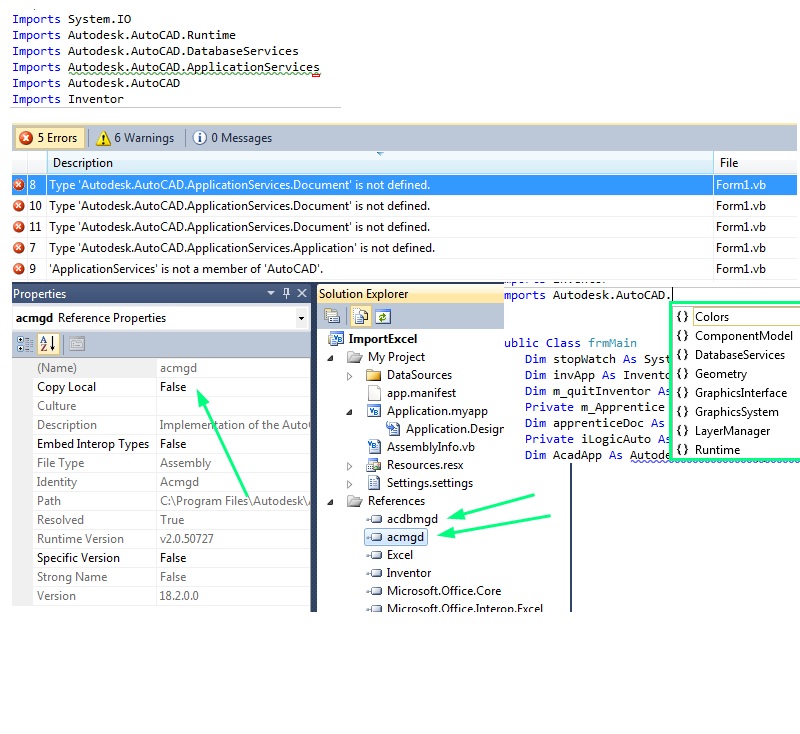

However, that does work for me, not sure why. I'm using VB 2010 Express, and really enjoying it! When I add my references, acdbmgd and acmgd from AutoCAD 2012 folder, everything looks good. When I hit compile, i get the errors shown in the attachment.
What have I done wrong?
Thank you for your help.

So, I found the advanced compiler options! It was set to '.NET 4 Framework Client Profile'. If I change it to .'NET Framework 4', it compiles, but doesn't run.
Error is thrown before form appears.

The fact that it compiles but does not run, and the other clues from what you have sid in this thread inducate that your have an issue that is different from the other thread you mentioned:
You are doing a stand-alone VB.NET EXE project, aren't you?
If yes, then you CANNOT USE AutoCAD .NET API assemblies (acdbmgd.dll, acmgd.dll...), thus the error you got when trying to run your app.
For EXE app, you can only use AutoCAD COM API, or you can do Acad .NET API DLL project and expose it as COM (if you know what does that mean).

Norman, I think you've got it! I neglected to mention that its a standalone app, mostly incororating Excel to Inventor communication. I'm using the AutoCAD bit to update a title block.
