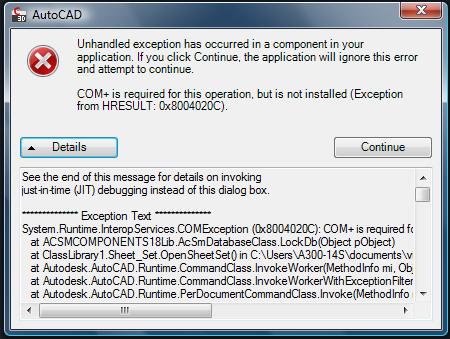

Also now I am getting some warnings and while using the compiled dll in autocad, when I am entering the app command I am getting error saying COM+ is required.

What kind of application are you doing and where does it run? You are not doing something that runs on the server side, are you?
Norman Yuan
Drive CAD With Code
No, I am not doing which run on server.

I put together some simple code that works with Autocad 2012 (64bit). I tried with both VS2008 (targeting .NET 3.5, which I commented out "<supported runtime...4.0/>" in acad.exe.config) and VS2010 (target .NET 4.0). Both works.
In both projects, I added reference to AcSmComponents18 1.0 type library from COM tab of References dialog box (i.e. I set reference to the registered DLL/TLB installed by AutoCAd, not by browsing to the one from ObjectARX SDK). Once the reference is set, VS generate a ,NET wrapper to the COM component: Interop.ACSMCOMPONENTS18Lib.dll

 Compile and NETLOAD the code into AutoCAD, and run the command "SSInfo", the sheetset's name prints at command line correctly.
However, there is one thing I have to point out:
InVS2008 project (it would be the same as VS2010 project targeting .NET3.x), the Copy Local of the generated interop assembly should be set to True.
While in VS2010 targeting .NET4.0, if I set "Embedded" of the interop assembly to False and set CopyLocal to "True", I get runtime exception when the code instantiate AcSmSheetSetMgr class. I had to embed the interop assembly. This is different from what I said in previous post. However, there are reports saying embedding interop assembly in Acad add-in would not work (see this link http://www.theswamp.org/index.php?topic=41497.0).
So, I guess, we have to try both embed and not embed in somce cases.
Nonetheless, the code shown above works form me.
