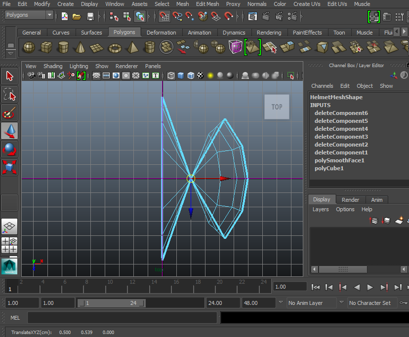

You made my frustration flee. Thank you. I have encountered another problem that I hope you can solve. I am trying to straighten out these edge loops and when I snap to grid, the helmet vacuums to the center. Before and after:
Screenshot Helmet
How must I avoid this?
Thanks for your help!
damaggio
in reply to: Anonymous
You can't select an entire edge and snap to the grid like that because is no longer a flat object and has width and height now, you can straighten the edge from the top view by simply  using the scale tool pulling the X edge complitely flat, remember that these operations work on Edges, Vertex and faces, you can also use lattices under Create Deformers.... and remember to keep deleting history.
