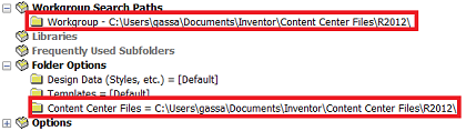

Please, try the following.
  • Edit the project.
  • Add the path “L:\CAD_POOLS\INV_CC” under the Workgroup Search Paths as well, disregarding the warnings.
  • Open the main assemblies containing the Standard Parts. You should not get the Resolve Link dialogs.
  • If this is the case, save the assemblies, edit the project and remove the path from the Workgroup Search Paths.
  • Try to open the same assemblies and tell me how it goes.

If you edit your project and set in the CC File folder path the old path P:\CAD_POOLS\INV_CC, can you open the assemblies without the Resolving Link dialog?
If yes, theoretically there is no reason why, moving the CC Files to another mapped disk and (important) keeping the same folder structure (i.e.: L:\CAD_POOLS\INV_CC), you should get the resolve link.
By the way, please try this one and let me how it goes.
  • Edit the project.
  • Add the path “L:\CAD_POOLS\INV_CC” under the Workgroup Search Paths.
  • Edit the CC File Path pointing to an empty folder.
  • If this is the case, save the assemblies, edit the project and remove the path from the Workgroup Search Paths and set it for the CC File folder.
  • Try to open the same assemblies.
