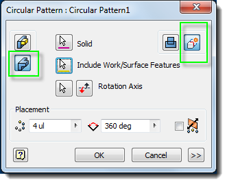

I have a pressure vessel which I am trying to analyse.  Whenever I convert the solid into 'thin bodies', it loses some of the data.  For example, a fillet and a supporting ring (refer to pic attached).  I haven't been able to find any 'shell element' settings to adjust.
Also, I need to manually add contacts otherwise the vessel seperates into multiple bodies.
Even though the solid model is in contact, the 'midsurface' shell seperates it.  Refer to part file attached.

  The shells work on a per-body basis.  To cure the first issue (supporting rings and feet being removed) you can use the multi-solid body approach, so that the supporting rings and base feet are 'new bodies' and not booleaned to the main tank body.  Another option is to model it as an assembly and this will be taken care of automatically.
  You could choose to keep the rings and feet to be meshed as solid bodies, having a mixed-model simluation (solid and shell element simulation).  However, the 'Find Thin bodies' command suggests a using a shell approach for all bodies.
  A 'gap' will often be created for a non-constant thickness portion of the model when Midsurfaced.  If this is not desired, try using Shell Offset instead of Midsurface.  Better yet, adjust the solid model so that it has a constant thickness throughout (such as a typical part with a bend created in the sheet metal environment).
  This can easily be done in your model by adjusting the fillet radius in the sketch of the tank for the revolution body.  The fillet OD should be ID radius + thickness, or ID = OD - thickness.
  I've attached a revised model illustrating these two approaches.

henderh
in reply to: henderh
I overlooked the fact that you have to make the circular pattern as 'new bodies' as well.
Apologies for the oversight...
-Hugh

Hi Hugh,
Thank you for your help.  That makes sense.
I still had some trouble with the radii missing on 3 of the (patterned) legs.  I fixed this by deleting the feature pattern and using pattern in sketch mode.
The pressure vessel also had holes in the bottom where the 3 patterned legs joined to the base.  The edit described above fixed this too.

Hi hagiographa,
<<I still had some trouble with the radii missing on 3 of the (patterned) legs.  I fixed this by deleting the feature pattern and using pattern in sketch mode.
The pressure vessel also had holes in the bottom where the 3 patterned legs joined to the base.  The edit described above fixed this too.>>
  Yes, the gaps in the patterned legs were due to not taking the multibody or assembly approach when modeling the legs.  The fillets in the legs are constant thickness so they were 'discarded' by the midsurface.  The reason for this is that if a face is much smaller % wise.  This is done automatically and is part of the midsurface algorithm, it usually doesn't have an adverse effect such as this if the model is prepared with this behavior in mind.  I didn't see this effect after I edited the circular pattern using MSB (revised model attached).  Perhaps I'm not seeing the effect you're describing in the revised model.
<<Do you recommend using an assembly over a multibody part?>>
Since part and assembly analysis both work on a per-body basis (as opposed to per component-basis) the two approaches are nearly equivalent.  The most significant difference is that you can apply different materials in the assembly approach, since we cannot assign a unique material to bodies with MSB's.
A minor difference is in the behavior of feature suppression.  In a part analysis, if there are downstream failures of dependent features because it's 'parent' is excluded, those downstream dependent features are excluded automatically.  In an assembly analysis, if a dependence such as an (assembly constraint fails due to geometry changes) the exclusion is not possible until this is corrected manually, by adjusting the model accordingly.  This doesn't really matter in this model, but is something to keep in mind in case it comes up in the future.
Now that the model is converted to a multi-body model, you can easily use the 'make components' command to convert it to an assembly.  I've attached a model taking this approach so you can compare any slight differences in behavior
