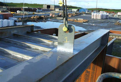

I have a fairly "simple" FEA problem that is causing constraint issues for me.  I will simplify the description:  20ft x 6ft steel lid with 6" flanges all around.  The lid has 4 lifting lugs close to the corners that will allow lifting from a single point.  I want to see the affects of the lift through the plate.
I can do the forces by hand but am having issues figuring out where to place constraints to mimic this problem.  If I place a single fixed constraint at bottom face of lid, then of course I don't see the affects of the forces that will be exhibited longitudinally through the plate.  If I use sliding constraints obviously there will not be enough constraints.  This should be quite simple but has me perplexed.  Any idea?

I would probably model chains, but ...
If you fix one lug and have the others sliding, how would that work?

I didn't mean you would have to constrain all the little links, but I would make something to approximate the hook in the lifting lug. Then you could fix the other ends.
Unless the people doing the lifting have some sort of spreaders, the angle of the chains could be a significant factor (and it would change as the thing deformed).

Yes - I understand what you are saying about the chain - I will try playing with some way of constraining to see if I can then leave my calculated forces out of the FEA altogether.  I will try modelling a single link as my lugs are d-links that i can then rotate to proper orientation .  (I am also trying to avoid a spreader bar as it will probably not be necessary in my case pending FEA results.)

If you can determine the angle of the lift chains, it's quite simple to determine the force vetor components. Or just model long lift bars/single links to a central connection.
