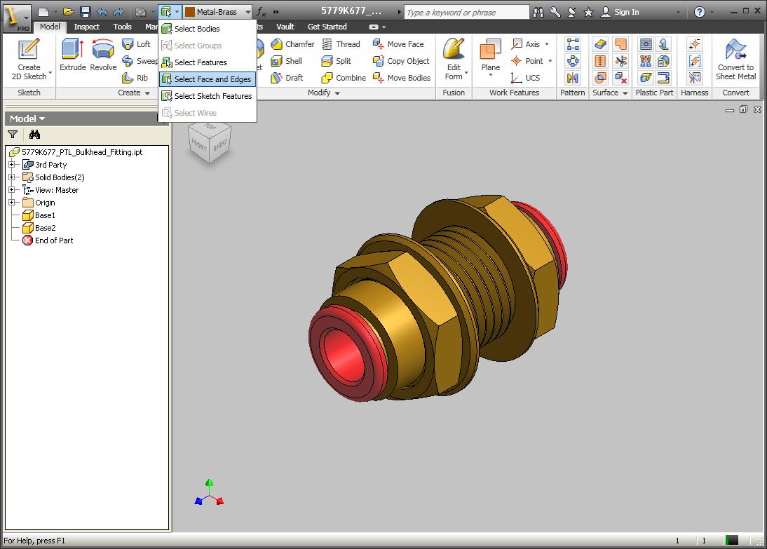

Make sure your selection filter is set to face and edges,
Message 11 of 17
divingdoug
in reply to: Anonymous

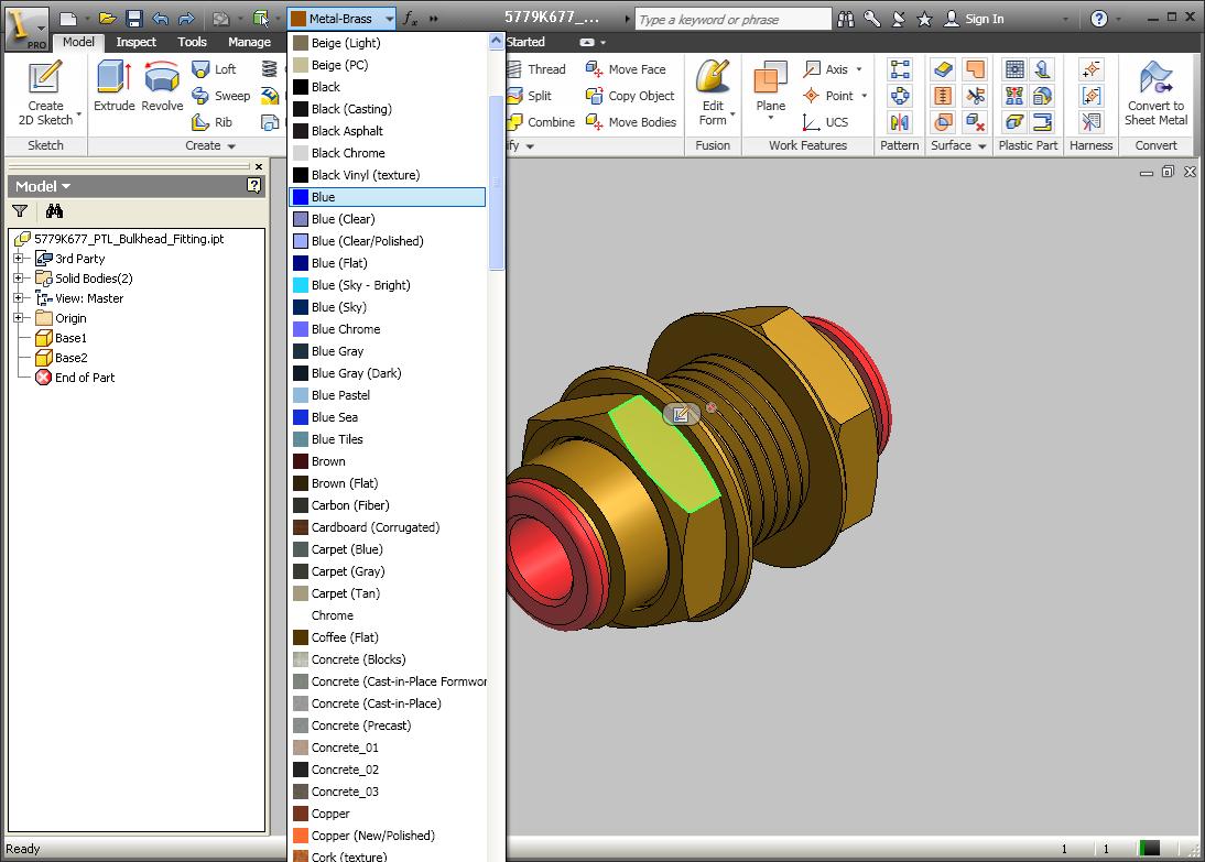

Screen shots of what I did
1) Verified the selection mode
2) Select surface
3) Select alternate color/matl
4) Result - Notice face is still selected
Tell me what I am missing, please
Doug
Message 12 of 17
in reply to: divingdoug
Select the middle of the face, stay away from the edges.
