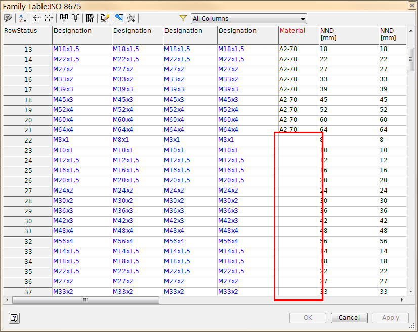

first of all here you see two shots of how the problem is showing up. The third one shows how the problem comes in the family table (I know that you see several times the same column header: that has been done with photoshop because I am not allowed to disclose certain details of our content center. In any case in those columns there are string values that are not relevant for modeling purposes).
No, I don't think we have one single "standard" material in our library (maybe we have generic/default, but for sure no standard parts based on them). So, even this A2-70 that survived in a couple of cases is NOT a standard material.
in this case all material variations got lost.
In this case one non standard material survived. All the other (11 variations) got lost.
Here you can see the missing cells in the family table (certain columns have beed covered due to copyright issues).
As you can see the members are still there, but the value in the Material column has been lost.

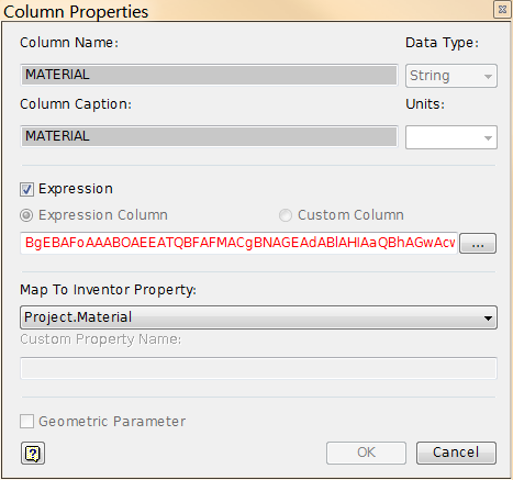

Yes, the material column is the native Autodesk Material column mapped to Project.Material

Maybe I was not clear: the problem is not affecting migrated parts: those parts have been properly migrated, and they all have their right materials. The problem is coming up when calling the Content Center by "changing size" or by inserting new CC components. As you see from the next image
if I patiently edit the material table and restore the missing cell, everything comes back to work. My problem is that I have almost a quarter of a million members!!Smiley Very Happy

Coming back to the original subject, while repairing the material links I noticed the following peculiarity: in most of cases materials were defined as "expression" for the fist grade, and as override for the following. If I am not wrong this should be also the default Autodesk setting.
- 99% of the overrides have been lost (for some strange reason a couple survived)
- most of the "expressions" got somehow damaged (see image), and then the material has been lost
- a minority of expressions survived, and in those few cases also the material link survived
example of damaged expression
Now I am removing the "Expression" tab from cells, so that the content of that column will be a pure string. I hope it will help for the future...
