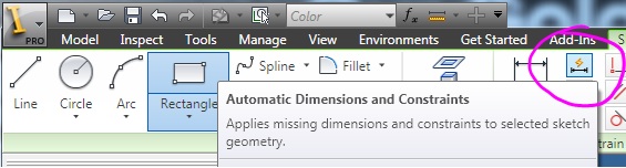

Click on "Automatic Dimension" to see what's needed.
