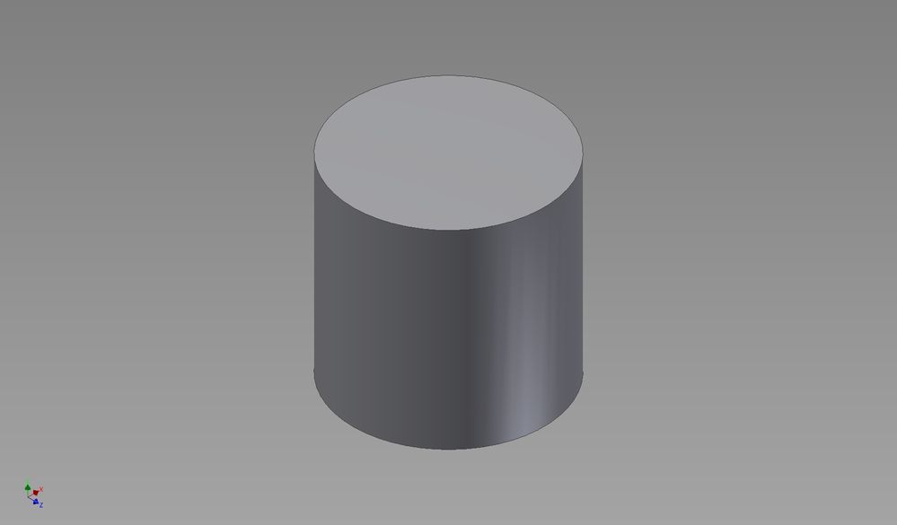

When modeling in the Inventor environment I prefer to use a custom gradient background. When I create image captures for presentations I prefer the images to maintain a white background. Is there a feature which easily allows me to do so?
Tools>Application Options>Colors and set to Presentation (one color) background.
Or use Presentation background in Studio.
This is doable yes, but unfortunately this method doesn't lend itself to an iterative design process. This means each time I want to export an image capture for presentation I would have to change my Application options Color Scheme, and Background type... I will also have to reverse these selections when returing back into work mode. I'm confused as to why Inventor wouldn't include this as a standard bare-minimum feature... From an Industrial Design perspective this feature is absolutely necessary. Perhaps Inventor's primary focus isn't intended to be a design tool as much as it's an engineering tool?
